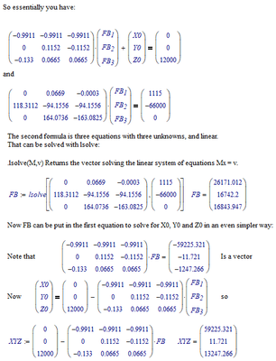

My answers are different from yours. I may have made an error somewhere...
Anyway, you should be able to do this in Prime.

For the upper left matrix, the determinant is 0, it means the matrix is singular, or in other words, it cannot be inverted.
 That means that lsolve cannot find a solution.
For the lower left matrix that's not the sae, and lsolve can find a solution.
(To:XDN)
Maybe this helps..?
