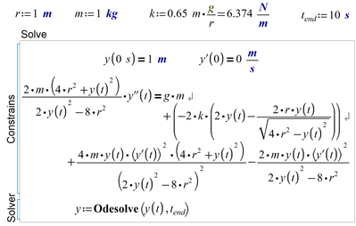

Attaching my "in work" file (clearly not done!) for comment/correction.
You sure are right that omitting the friction is mandatory, at least in the first attempts. And it sure would be interesting to see if you can achieve the oscillation Valery expects.

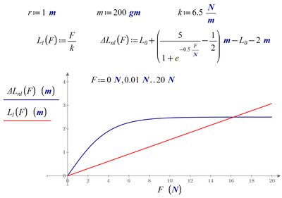

Once again, you are correct. A rubber band is a poor spring. If you do an experiment you will discover that it has hysteresis, the loading curve is different from the unloading curve:
So we could find a different expression for the force/extension curve and even account for whether the band was expanding or contracting. But the assumption that it obeys Hooke's Law, like ignoring friction, is a good first approximation.
Non linear Hooke

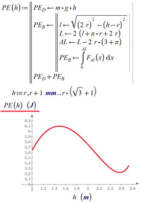

Pictures for new new problem. And Prime 6 in attch as the first step
New new new problem!
Is it correct? Prime 6 and Mathcad 15 in attach!
