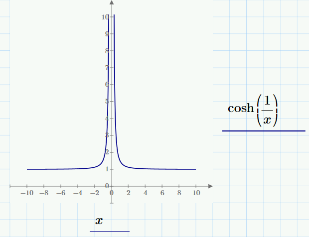

I assume you are using Prime. You have to be aware that on every axis you are able to change the first, second and last value to whatever you like (see the picture. Its rather hard to spot and to do, but, alas, plotting is something which is implemented in a ridicoulous unprofessional and insufficent way by PTC.
Using Werner's tip (I didn't realize you could adjust three. . .)
I get the following:
With log Y scale:

Ah, the problem is that you don't get to see a plot for positive x.
If you define x as an appropriate  range, you will:
