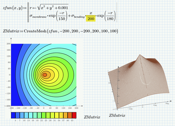

In the meantime I was curious and played around with the AI proposal.
I guess you are looking for that kind of plot:
On contrary to the AI proposal grid size 20 means in my approach to divide the range from -200 to 200 into 20 intervals and so we have a 21 x 21 matrix and not a 20 x 20 matrix is suggested by the AI.
May be a matter of personal preference or habit how to interpret the term "grid size".
EDIT: An easier way to create the plot is to define a function for the z-values depending on x an y and then use "CreateMesh" to create the necessary data structure:
BTW, is there a specific reason for the addition of 0.001 in the calculation of "r"?

I'll try to add my worksheet - let's see if it works for me.
I added a 3D plot,
but it doesn't look good in Prime compared to real Mathcad. Here mathcad 15

AlanStevens
I've been trying this with Prime Express and have been puzzled for some time as to why my (simple) contours were so different from Werner's.  The difference has been driving me round the bend!  Luckily for my sanity, I've just noticed that there is a difference in the definition of the value of Z used by Werner and Ranto.
xval is divided by 200 in Ranto's case (which is what I used).
Alan
(To:AlanStevens)
Arghh! Sorry for the confusion. I remember that I had a second look at this very expression because I wondered if there really was no factor xval or yval at the first summand, but completely overlooked the most obvious division by 200.
Small cause, big effect:
As contour plot is a premium feature I suppose you created it using the 'normal' xy-plot?

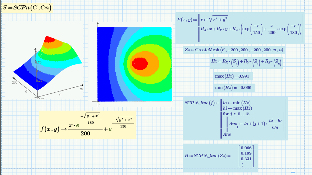

AlanStevens
Yes.  Here is an image of my rather simplistic attempt at a 3D graph and a contour plot.  (Incidentally, although ranto originally asked for contours of 10, 20, 30, 40, 50, 60 and 70, I note that the last three aren't possible as the largest value of Z is just over 40.)

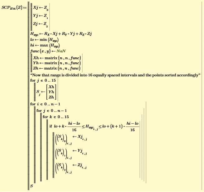

Just realised there's a much better way of calculating contours for this problem using polar coordinates:
Alan

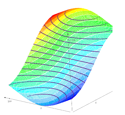

And, just to show it can be done in Prime Express, here's my combined 3d/contour plot:
Alan

We can change the direction of hight not only z axis but -z or xyz etc.
Computer display shows white shadow but copy and past here, it shows no white shadow.

Make contour lines for colors bands.
Version up contour lines by using Program author: Viacheslav N. Mezentsev, 2006, Uni Home Lab, All rights reserved. Algorithm same as well as for implicitplot3d(), uploaded by Werner_E.

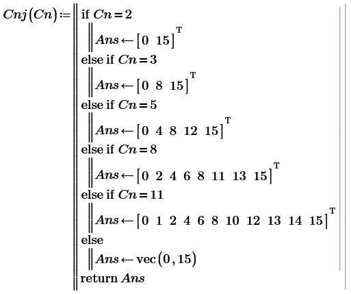

Now, number of colors can select by Cn vector.
