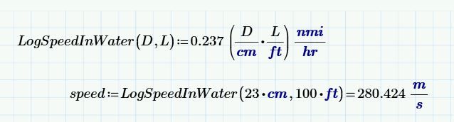

5) I have several very special proprietary (secret) imperical formulas that have been developed through testing and their units cannot be rationalized. I would like to develop a method for using this equation.
Easy say your imperical formula was for speed of a log in a river based in diameter in cm and length in feet then
gave the answer in knots. Once the definition is made you can enter D in imperial or metric and it is converted to cm internally to suit the units of the empirical equation.
