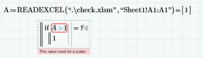

Hi all I am using the readexcel function in mathcad prime 6.0.0.0 and to even read in a number it comes in as not a scaler. is there a set format in excel that i am missing as you can see the number below comes in in brackets [1] as an example. I have tried both .xlsx and .xlsm file types both give me the same.
note: the if function below is just an example to show I cant use the data brought in because of the [1] (brackets).

You should (ALWAYS) attach THE worksheet, or at least A worksheet, that demonstrates the problem.
Anyway, I can see that you DID NOT type the opening square bracket before ORIGIN. It isn't there for nothing.

(Apparently) READEXCEL reads in the data from the excel file as an array (or a 'vector' if you will). If you only read in a single number, it will be a on-element vector in Prime. That's what the square brackets indicate.
If you take the first element of that vector, you have your number.
If you type
[ORIGIN
At the end of calling the READEXCEL function, so immediatley after the closing bracket ) and before the  =
that should do it.
Alternatively you can take the element in your little program, by adding the [ORIGIN to the variable A.
Note that if you have a vector, you cannot compare it to a scalar (=single number).
