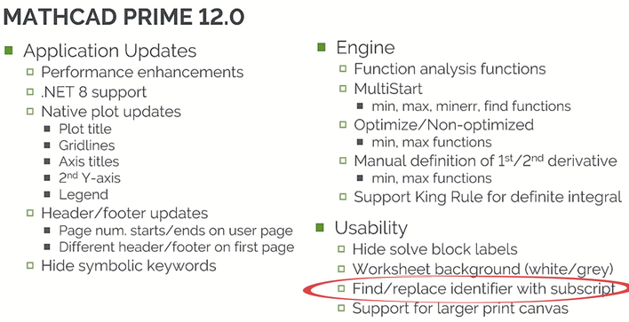

EDIT: I just gave it a try to see what that 'improvement' in P6 mentioned in the help would look like:
When we have a definition xa:=5 and look for a to replace it for b, in P5 the  variable name is replaced fully and  we get b:=5, while in P6+ we get xb:=5. Isn't that great!? So the question is just how long it would take PTC to implement a search for a subscripted variable name and replace it for another subscripted one, like replacing xa with yb in one go.
Not sure if upvoting this "idea"  or this" idea" (more than three years old) would be of any help, though.
EDIT2: Good News! According to this "Sneak Peak" we will get the desired functionality 'already' in Prime 12 which is scheduled for Q2 this year:
