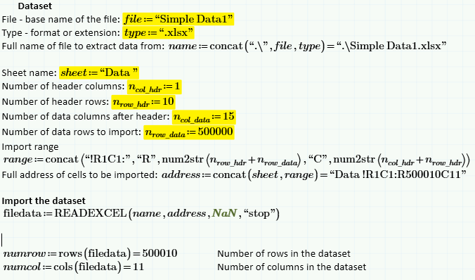

I am working on a Mathcad Prime 5.0.0 worksheet. My goal is to import data from Excel, and later in my worksheet run data analysis for the found set.  I am struggling a bit to emulate the behavior for CSVs where the imported data is limited to non-blank rows and columns (once it finds the empty rows and columns it automatically stops importing). The help indicates a way to command READEXCEL to "stop" on a blank row. The problem is that I cannot get it to work. Maybe the previous emptyfill parameter where you fill blanks with something is preventing the "stop" on blank? I cannot figure out how to make it work, and all of the examples use only the most basic inputs.  Any ideas?
The screenshot shown below shows that though I try to "stop" on blankrows, it is persisting; I get all 500010 rows even though there are only 180k lines of data.  Perhaps the substitute of NaN is the issue? I have also specified "" as the emptyfill and gotten the same result.

I don't think so. I want to define a wide range of both rows and columns, and have the import, at least for rows, stop once it runs out of data.  That is, even though I have defined 500k rows, if blank rows start at 180k the import should stop.

It looks like your solution is substituting the string "stop" as emptyfill, and I see the program doing that; filling the empty cells with a string.
For my program, I would like to specify a fairly unbound end row. My current code shows 500k but even better would be 10M. I want the data import to auto stop at the first empty row, and not actually run out to the range I specified.
The ability to "stop" on an empty row seems to work with this small sample file. N is only two rows.

The syntax you use is correct and should work (and indeed does so in a small example file I created)
basically Terrys lat post shows that, too. You may replace the string "blank" in his example by NaN.
So if it does not work with your Excel sheet, it might be that the row you think is empty in reality contains some hidden data and so is not seen as empty by Mathcad.
You should create a smaller sample Excel file and post it here along with your Prime worksheet.
