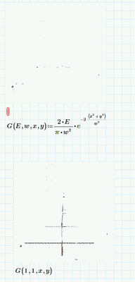

My 3D plots have started appearing like this:
When I drag the plot area, the problem disappears:
But as soon as I let it go, the weird pattern reappears.
I thought it might be a problem with the mesh frequency pairing with the pixel spacing on my display, but resizing does nothing, and, in fact, the problem appears as soon as I open a new 3D plot area.
Anyone encountered this?  More pertinent question: does anyone have a solution?
Working in Prime 8.0.0.0
Thanks for any hints.

Sure.  But it's as simple as: open a new worksheet; insert 3D plot.  Then plot whatever function you feel like displaying.  You can even skip the "plot whatever function you feel like displaying" and the problem still exists, as you can see in the screenshot below.
Graphics card?  I don't know.  On my device manager I see Intel UHD Graphics and NVIDIA RTX A2000 8GB Laptop GPU.  Does that answer your question?
Must be a video card issue...OR, it's a Prime 8 issue...my screen image here is from Prime 9 - looks normal.
