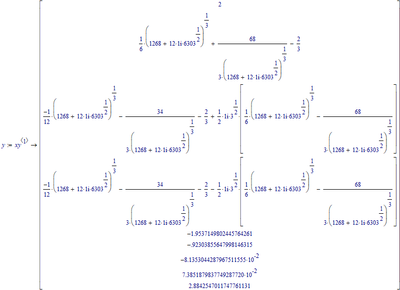

Means we have 9 solution pairs for x,y. The x's are:
The y's are:
And numerical approximation gives:
Interesting! So MC11/Maple switches to float mode partially when it can't solve part of an equation in pure symbolics.
Its irritating that the exact solutions are the ones with a small imaginary part when evaluated numerically.
I guess that a symbolic evaluation with float could avoid that (actually it doesn't in MC15).
