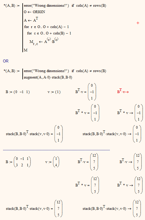

Ifomenko is using real Mathcad, so one workaround (not in the least satisfactory) could be writing a function for matrix multiplication, give it the name * or maybe even some kind of dot and use it with inline notation. Clumsy and awkward, I know.
Another "fix" (no, I wouldn't really call it a fix) is to add a dummy row made up of zeros to both matrices/vectors B and v to force the symbolics to do matrix multiplication. Doesn't look good, though.
The trick with the dummy rows could also be used in the self written matrix-multiplication routine instead of the nested for-loops.
Mathcad 15 file attached.
