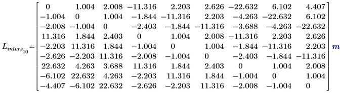

Of course you can access individual elements the usual way, here the matrix you get for Beta with index 10:
