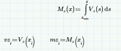

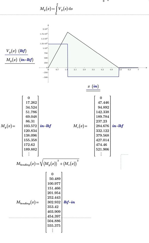

I'm pretty new to Mathcad like today new, and all I'm trying to do is multiply and take the square root of a bunch of values in matrices but I can't get it to work for the life of me. I've attached a screenshot. My project consists of plotting a bunch of bending moments and shear force diagrams so I have two matrices from two plots with about 500 rows of values and just want to do a simple calculation to get another matrix output that I can take the maximum value from. Any help would be greatly appreciated. Ive also attached the file below in case anyone needs that.

a) There is a difference between a vector of values "x" and a range variable "i" that references each individual element of "x".
b) There is a difference between a definition of a function Mz(x) in terms of x and an evaluation of the function many times using "x" the vector at each index "i".
c) You use the vectorise method to work on vectors and matrices.  It is found on the ribbon at Math | Operators | Vector and Matrices in the bottom right hand corner is a capital V with an arrow over it.  You highlight the equation or part of equation required then select the operator.  You only need one vectorisation over the whole equation to get the right values.
d} I have enclosed reworked worksheet.

You have defined the moment function as a integration of the associated vector calculation of the program and place the definition of moment function above the bottom of the V calculation.  This means M uses the previous definition of V not the one beside it.
Correction enclosed.

Thank you this solved all my problems I was running into!! I really appreciate all the help and work you did! I am new to this community and forum so I believe I accidentally accepted the wrong answer for this question, if you know how to reverse that please let me know so I can mark this as the solution!!!
