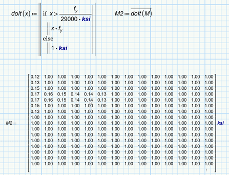

Here I use your first if-statement and apply it to every element in the matrix
