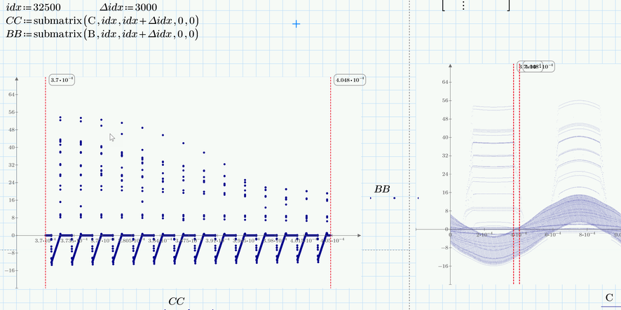

Yes, sure a huge amount of data - slightly less than 175000 data points.
As far as I understood Terry guessed(!) a sine as being the upper limit and eliminated all data above it.
I thought about automating that process by using an outlier function (without success).
If we zoom in (see picture below) we can clearly(?) see which data should be considered an outlier/spike. I thought about some kind of windowing and applying an outlier function peu à peu instead of treating all the data in one go ....?
I had not played around with that idea any further as the OP in that thread seemed to be happy with Terrys solution anyway.
