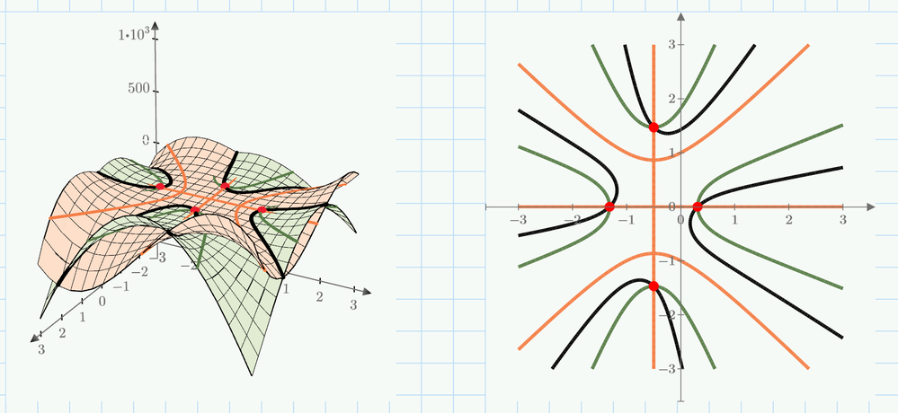

Here in more detail, using implicit2d() from Viacheslav N. Mezentsev
The green curve is the intersection of the green surface (real parts of function values) with the a-b-plane (function is evaluated for a+b*i).
The orange curve is the intersection of the orange surface (imaginary parts of the function values) with the a-b-plane.
The four solutions of your equation can be found in the intersection of both curves.
The a-b-plane is of course the Gauß-plane of the complex function arguments.
Of course the four solutions also are part of the intersection of the green and orange surface (points where real and imaginary part of function value are equal, black line), but I found the plot too much overloaded to be informative. Maybe, if your would have some degree of transparency, but Prime does not have any means to make a surface semi-transparent.

Extend yourself to four euclidean dimensions (you would be the first one being able to do so, I guess), plot the function and look, where the fourdimensional curve intersects the a-b-plane
You have a function f(a,b)=(c,d) based on your function f(x)=y with x=a+i*b and y=c+i*d
As an alternative look at my second answer.
Plot the green and orange curve in simple 2D and look where they intersect. Here the axis must be seen as real and imaginary axis.
The equation of the green curve is Re(f(a+1i*b)) = 0  and the orange one analog with Im instead of Re.
As we can't do implicit plots in Mathcad and Prime, you have to resort to either brute force (making a grid and for each point decide if it fulfils the equation or not; plot consist of a cloud of points only) or you use a clever user-function as I did - credit goes to Viacheslav N. Mezentsev who posted this function among others here in he forum 15 to 20 years ago. As an alternative you can use a different software which is able to do implicit plots like SMath, Geogebra, and all the other well known products.
