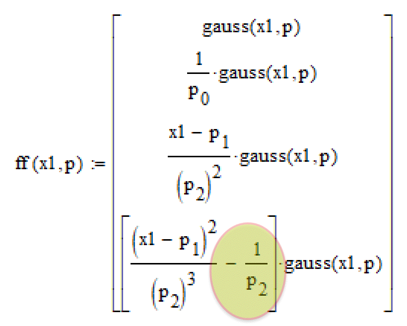

Here is the error in your derivative
(To:payman)
Looks like there is a problem with your gradient vector ff
If you simply replace it by the function to fit
you get a pretty nice fit

Thank you very much, Werner, a great help!
My worksheet is now running much smoother.
