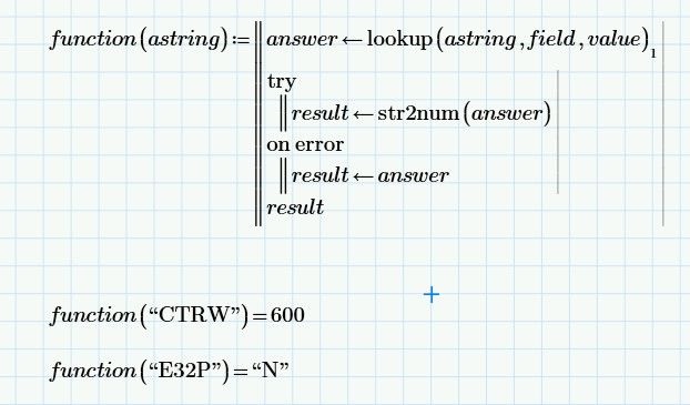

The result  is a matrix with a string as an element of the matrix.
Like this:-
The index of one gets the "600" from the matrix result of lookup ["600"].  The answer is a matrix as function allows for more than one match to the lookup

What you really need is a function that can read strings and numbers.
Try this
