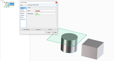

I'm trying to access the model name and read it in a tree format from Creo ED.
Tried a few Lisp APIs I saw in the document; didn't help much as none returned the model name.
 Have a requirement to read the Model Name (marked in green)for every Part/Assembly instead of the Part/Assembly Name (marked in red)

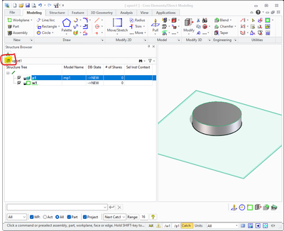

Press [Show details] in the upper left corner of the structure tree.
