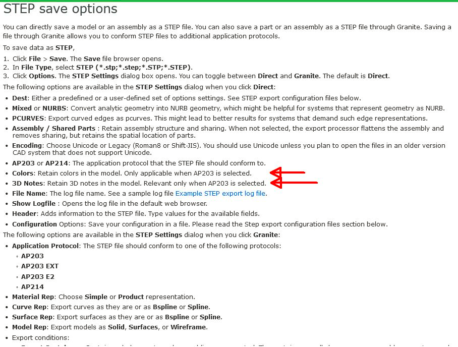

I looked in the "Help" and searched for the available options.
Then I added "all" possible 3D documentation to a model.
I then saved the model as .stp with the following options.
I loaded this .stp again, whereby I had also set the "Direct" option again.
Below is the result. Only the 3D note had been transferred, everything else was no longer there.
