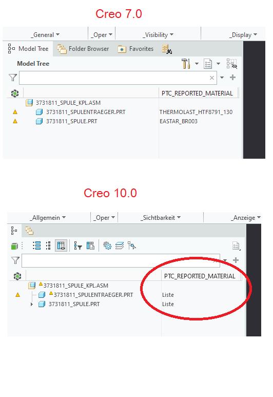

I am using Creo Parametric Release 10.0 and Datecode10.0.4.0
In Creo 7.0 I was able to list the PTC_REPORTED_MATERIAL parameter as column inside the model tree.
In Creo 10.0 the PTC_REPORTD_MATERIAL is not shown anymore. Instead there is always List (in German Liste) displayed.
Is there a way to display the active material of the model inside the model tree again?
Here are the errors that I faced
no error or warnin - the parameter PTC_REPORTED_MATERIAL is not displayed as expected.
try adding PTC_MASTER_MATERIAL as described in https://www.ptc.com/en/support/article/CS98870 article.

Thank you,
I already tried to add PTC_MASTER_MATERIAL and it was not working.
When I tried it now it worked out. It seems that I did something wrong the first time.
