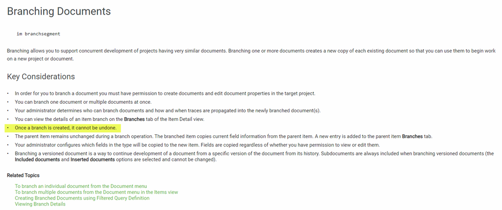

amund
(To:fhuber)
Take a look at the following: (Branching Documents (ptc.com))
This may be the answer (which you did not want...).
