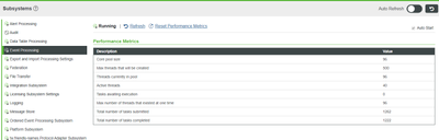

In customer's system,  the CPU usage is 100% because of the processes of PostgreSQL.
  1. If restart the postgresql service , then the cpu usage will creep to 100% in about 10~15 minutes
  2. The event processing subsystem received 1.5 tasks per seconds .  The active threads will increase until 75 (see the attached picture )
  3. Thingworx can work about 1 hour when cpu is 100% , then will found lots of error "Connection to localhost:5432 refused"  in ErrorLog.log .

  5. Query the table pg_stat_activity, found lots of long xact_stay,  but no long query_stay. (see the attached picture )
  6. CPU usage. (see the attached picture )
Any idea about it ?  The  workload is not so heavy , why is the CPU usage so high?
