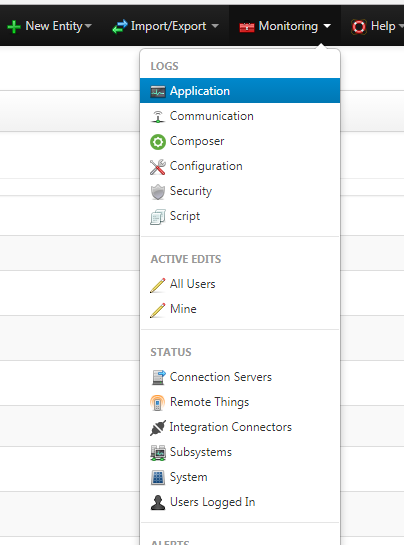

If you open the Applicationlog (through the monitoring tab) - what does it show?
