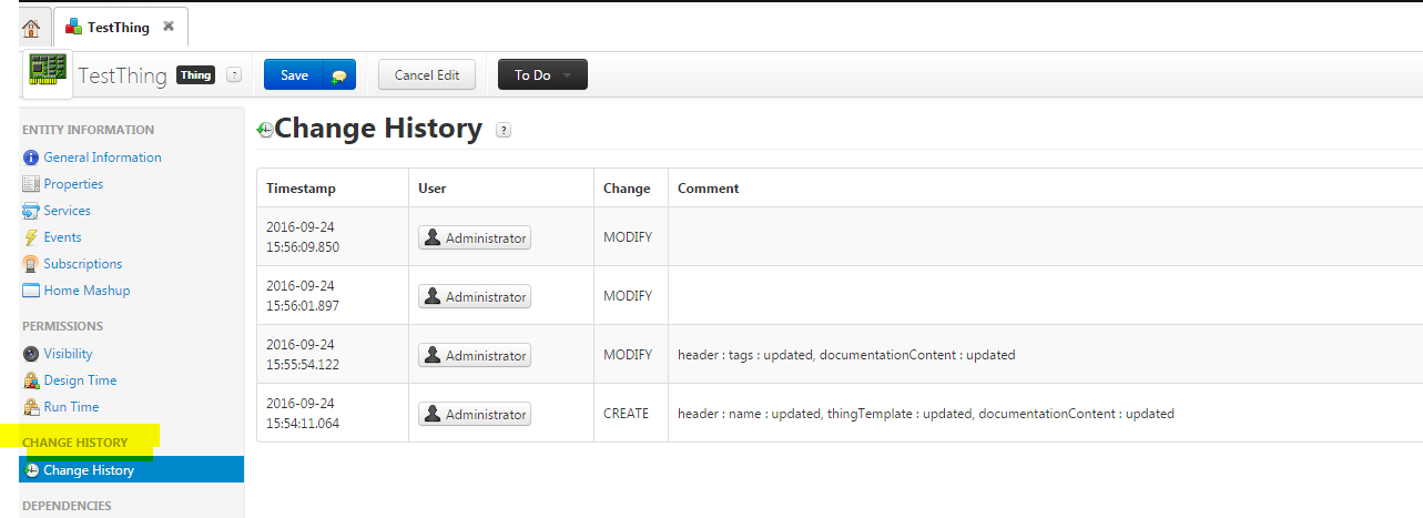

Hi @Naveen ,
Please clarify your question , as in what are you trying to do ?
Changes made to a Thing in Thingworx can easily been seen in Change History.
Please see the screenshot and let me know , if this is what you are looking for .

To get this ,  once you have made changes , to the property , you will need to a export from the Property tab itself .ChangesToProperty.PNG
Check the xml file and it will contain the changes made to the Property of Thing.
I believe this is what you are looking for .
