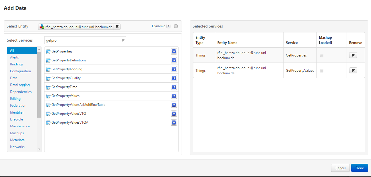

I can not see the properties of my created Thing in Mashup:
I dont get why, when I add a thing i can choose it and call getproperties() or getpropertyValues but it wont work!

The binding is above and it wont show the getproperties under the generated thing.
also when i press done button it wont disappear as usual when u add a thing with services to the mashup but it adds it as shown in Pic 1.

It looks like the mashup builder's hitting an exception, which is why Session and UserExtensions are showing up above the Thing.  You may want to coordinate with PTC Tech Support and see if this is a bug.
