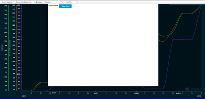

Hi slangley,
as i previous mentioned I've made some progress; I'm now able to display the chart, unfortunately this is displayed in background respect to the mashup .
I'm sure i have made some mistake writing the extension but, of course, where ?
Attached the extension I've developed, any help would be appreciate.
Thank you
Regards/Ciao
Giorgio
slangley
(To:gfontana)
Hi @gfontana
We suspect this has more to do with the library you're using than ThingWorx.  Which library are you using?  Perhaps one of our developers in the community will have some experience with that library.
Regards.
