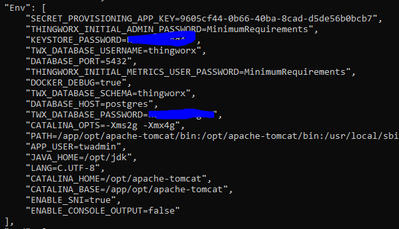

Running 'docker inspect' on the Platform container, I can see passwords are set correctly:
Still not sure why Platform can't reach Postgres, but still trying to find out.
