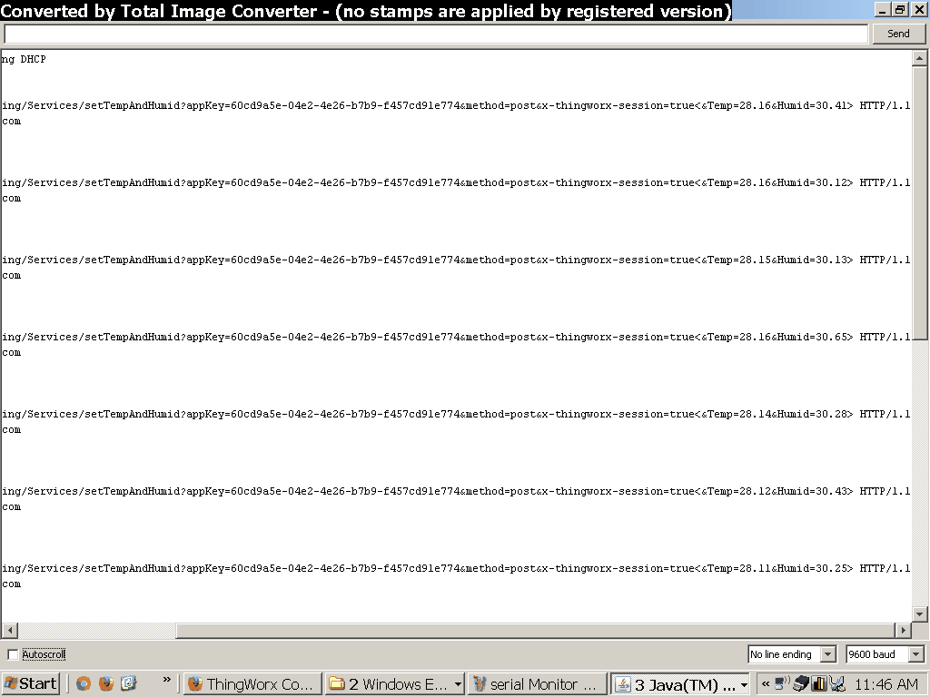

Can you please post a print screen of your Arduino IDE Serial Monitor with the REST calls that are being sent to ThingWorx ?

I see that you are using ThingWorx 6.0  The tutorial was developed on ThingWorx 5.2 and there is an additional step to  be done on ThingWorx 6.0 to make it work. You need to enable REST calls  by following these steps :
1.           Click on Subsystems under SYSTEM within the left pane of Composer
2.            Click on PlatformSubsystem
3.            Click on Configuration
4.            Check the box next to Allow Request Method Switch to allow all REST API calls through a browser URL
5.            Uncheck Filter Content-Type
Let me know if this fixes the issue,

Hai Good Morning Veronica,
It is working fine now,  i can able to see the updating values in my property.
Thank you so much for your great support veronica.

  // start serial port:
  Serial.begin(9600);
  while (!Serial) {
    ; // wait for serial port to connect. Needed for Leonardo only
  //initialize HTU21D object to read values from sensors
   myHumidity.begin();
  // start the Ethernet connection:
  Serial.println("Trying to get an IP address using DHCP");
  Ethernet.begin(mac);
  Serial.print("My IP address: ");
  Serial.print(Ethernet.localIP());
  Serial.println();
void loop() {
  // Aquire sensor values
  propertyValues[0] = myHumidity.readTemperature();
  propertyValues[1] = myHumidity.readHumidity();
  // wait the established interval of time before
  // reading values from the sensor
  // and sending them to the TWX server again
  delay(timeBetweenRefresh);
  if (millis() - lastConnectionTime > timeBetweenRefresh) {
    updateValues(propertyValues, client, server, appKey, thingName, serviceName, propertyNames);
void updateValues(double values[] , EthernetClient &client, char server[], char appKey[], char thingName[], char serviceName[], char* sensorNames[])
  //build the String with the data that you will send
  //through REST calls to your TWX server
  char data[80];
  strcpy(data, "?appKey=");
  strcat(data, appKey);
  strcat(data, "&method=post&x-thingworx-session=true");
  // if you get a connection, report back via serial:
client.connect(server, 80);
if (client.connect(server, 80)) {
    Serial.println("connected");
    Serial.println("HTD11Thing");
    Serial.println("setTempAndHumid");
    // send the HTTP POST request:
    client.print("POST /Thingworx/Things/");
    client.print("HTD11Thing");
    client.print("/Services/");
    client.print("setTempAndHumid");
    client.print(data);
    client.print("<");
    for (int idx = 0; idx < propertyCount; idx++)
      client.print("&");
      client.print(propertyNames[idx]);
      client.print("=");
      client.print(propertyValues[idx]);
    client.print(">");
    client.println(" HTTP/1.1");
    client.print("Host: ");
    client.println(server);
    client.println("Content-Type: text/html");
    client.println();
     client.stop();
    lastConnectionTime = millis();
    // print the request out
    Serial.print("POST /Thingworx/Things/");
    Serial.print("HTD11Thing");
    Serial.print("/Services/");
    Serial.print("setTempAndHumid");
    Serial.print(data);
    Serial.print("<");
      Serial.print("&");
      Serial.print(propertyNames[idx]);
      Serial.print("=");
      Serial.print(propertyValues[idx]);
    Serial.print(">");
    Serial.println(" HTTP/1.1");
    Serial.print("Host: ");
    Serial.println(server);
    Serial.println("Content-Type: text/html");
    Serial.println();
  else {
    // if you didn't get a connection to the server:
    Serial.println("the connection could not be established");
    client.stop();
