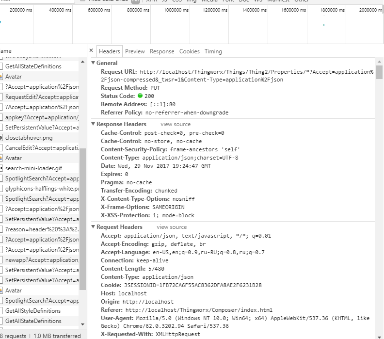

You would need the following headers: content-type, Accept, appkey.
You would send the image as application/json
For example:
The image will be in json:
Hint: you may use your browser dev tools (Chrome - f12) to see the REST call structure when assigning an image property through the composer:
Scrolling down to the  request-payload, you can view the source:
For example:

Try this.. Open your dev tools, upload your image to the property manually through the composer, then copy the source from the request payload and try to paste it exactly as it is in your REST call.
