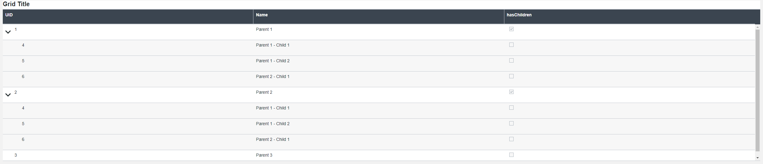

Hello.
I'm trying to use the Tree Grid, within the Grid Widget.
I have created two Infotables. One with Parent Data and another for Child Data.
Parent Data Output:
UID (Long)Name (String)hasChildren (Boolean)
1Parent 1true
2Parent 2true
3Parent 3false
Child Data Output:
UID (Long)Name (String)ParentUID (Long)
4Parent 1 - Child 11
5Parent 1 - Child 21
6Parent 2 - Child 12
Bindings:
Data: -> Parent Data Table
ChildData: -> Child Data Table
IDFieldName: UID
ParentIDFieldName: ParentUID
HasChildrenFieldName: hasChildren
Result:
With the following approach mentioned above, I have 3 rows as output.
Row 1 and 2 can be expanded to show the children, but not row 3 as expected.
However, if I expand row 1, I have all 3 Child Data Rows in there.
If I expand row 2, I also have all 3 Child Data Rows in there.
I don't know what to change anymore.
Can someone help?
Best Regards.
This was solved by using one Infotable with Parent and Child information.
