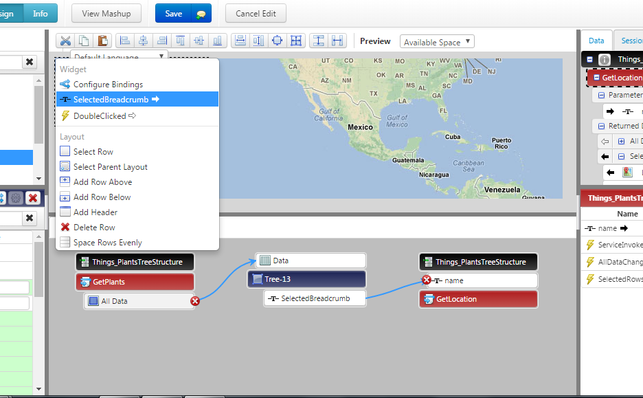

We did as per your comment be we are still unable to navigate to selected location on Google map. I am attaching the mashup, datashape and thing for your reference.
If you need more details please let me know.
Omkar
ankigupta
(To:odarde)
Try linking like below:
