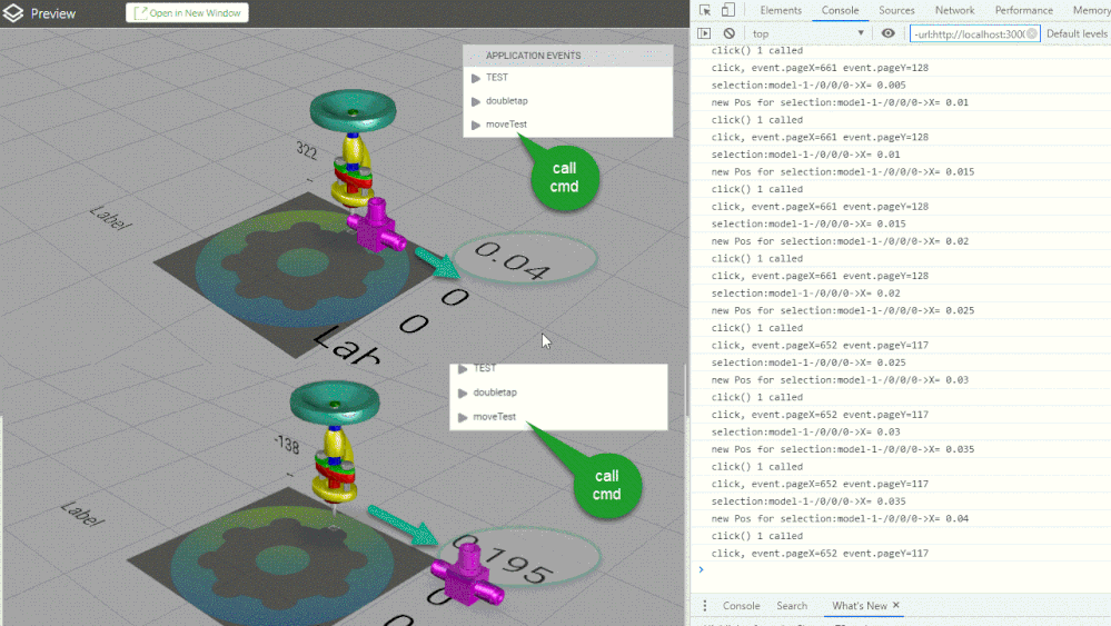

we can  assign the json to a variable e.g. $scope.COMP_LOCs
So later we can read the current position data on end device:
var selection_location=$scope.COMP_LOCs[l_currentSelection]
//read the location data from json varible console.log("selection:"+l_currentSelection+"->X= "+ selection_location.position.x);
//print it to console selection_location.position.x= round(parseFloat(selection_location.position.x) + 0.005,4)
//add 0.005 shift and round to 4 dec

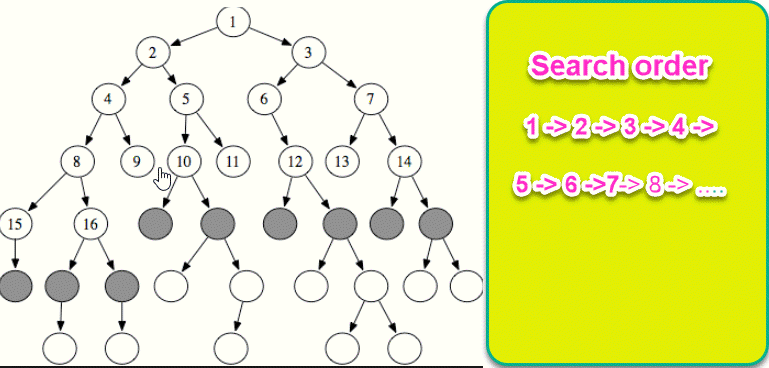

One possible algorithm is the deep first search:

The another possible algorithm is the breadth first search:

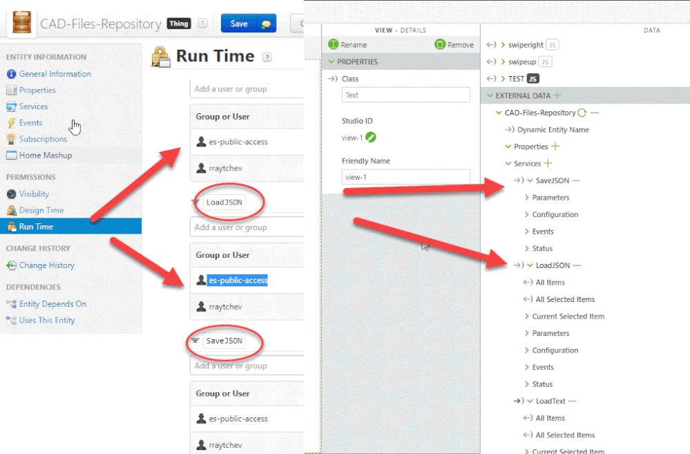

When we want to save data  (the generated json list) we need to use another workaround - we can use a thingworx repository. Following functions /events could be used to save and receive an json object to/from a twx repository:
// the methods SaveJSON and LoadJSON
// for the repository object should have
//run permision for  es-public-access user
$scope.SaveJsonToTwxRepository = function(path, content) {
 $scope.$applyAsync(function() {
    $rootScope.$broadcast('app.mdl.CAD-Files-Repository.svc.SaveJSON',
                          {"content": content, "path":path}
                         );}   ,500 );

The Thingworx services should have run permission and it is required to be added in the external data panel :
So when we start the project in PREVIEW mode we can call the search for the assembly structure and save it then  to thingworx. In Vuforia View mode   then we can receive the previously saved json object from thingworx.
