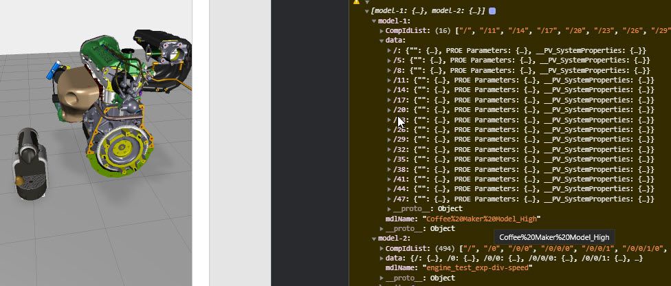

 The code listed above will load the json file to the modelWidget/s (it will works also if we have many model widngets there - and each model widget ponts to model which is imported with metadata)
When we  test this code we can check the object in memory (console.warn() ) :
Now we can access the metadata using the normal JSON functionality - so we can   access the component data via the Comp Path Id / id paths - corresponds to the modelItem widget property occurrence:

When we test the listed code above we will have in the chrome console window:
Using furhter the json  functionality we can also implement e.g. some user picks where you can associate it with the metadata :
