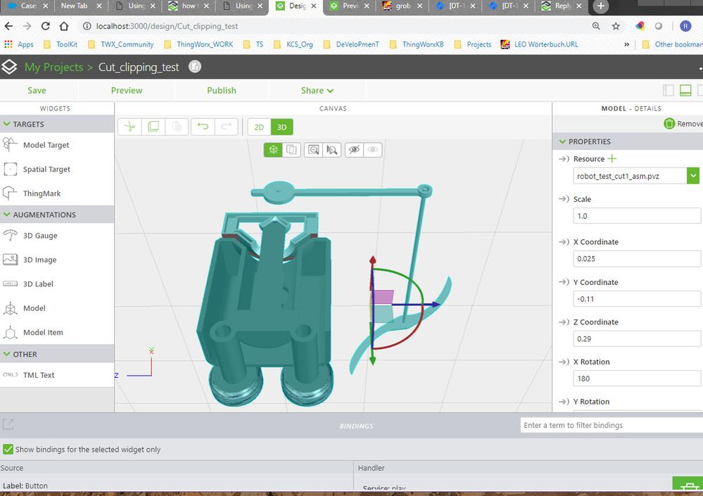

1.) uploading different models -  so we can use an additional models for each cut and then we can change the model if you want to display a cut, it means you can make the one model not visible and the display the second model or vice versa.  I tested with cuts created in Creo Illustrate 5.0 and Creo View 5.0 but it seems that Vuforia Studio could not display them /neither as part of sequence or as static to the current figure:
The only possible  way in this example is to create in Creo an assembly cut /with option cut also on part level  and  then create from there a new .pvz model.
In this case this seems to work fine:

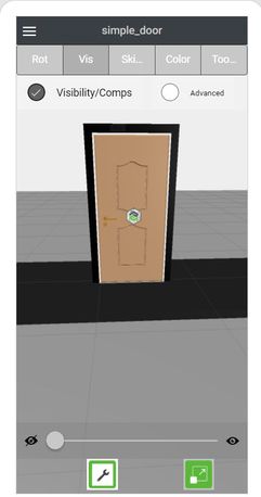

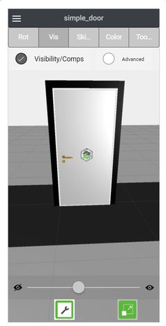

2.) the second approach is to remove components  step  by step,  so to see the inner components when the outer components are blanked:
All different components, which should be displayed or blanked, need to be defined as modelItem where we can set the visible property to true or false
