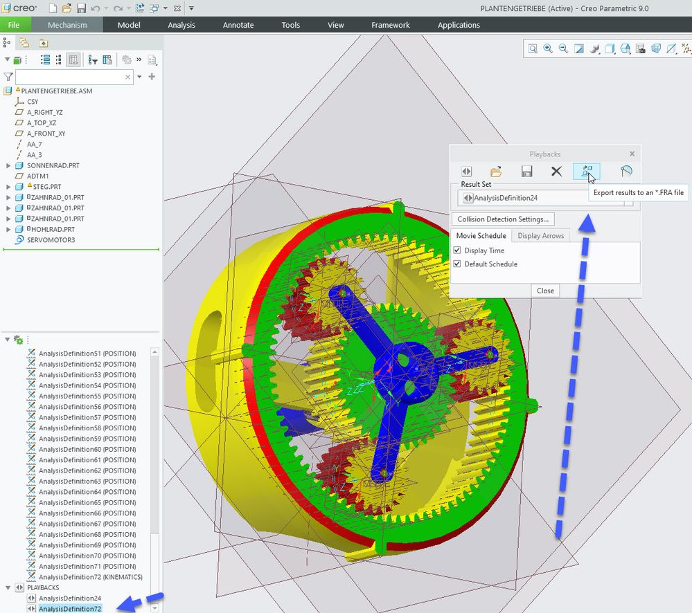

as described in CS266394        (as @VladimirN  pointed to)  it should generally  work. So  regarding this technique
we have to use .fra  file. So you can from Mechanism design export the fra file
and create the animation in Creo Illustrate (create first figure type animation and import then animation file (fra))
So the animation created from the fra file is a movement split to many singe transformations which will make this complex to handle within Studio when we follow the workaround first to add to a single step as mentioned in the CS266394 . Possibly there could occurs an issue when when you copy the time frame.
So my suggestions is to split the animation in Creo so that you should  not use to many frames in that animation . Let say you have animation over 10 secs. And it contains some actions which is repeated - possibly you can use an one fra  for smaller time frame or you have to create different fra files - and create animations which are in different steps . ( split the animation -  whole animation  is not in the same step)
Another point to reduce the timeframes in Mechanism as shown in the picture  e.g. in the picture form 101 to e.g. 30
This will reduce the number of transformation in the Creo Illustrate key frame
