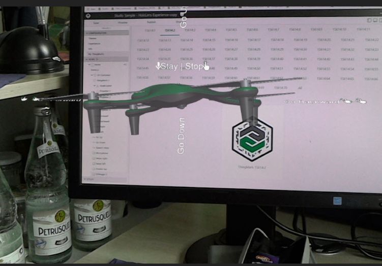

So I tested the project- first created a copy of it and then took a thingmark from my server:
Then publish it to the server and now tested the issue on the HoloLens:
So unfortunately I was not able to reproduce the problem.
