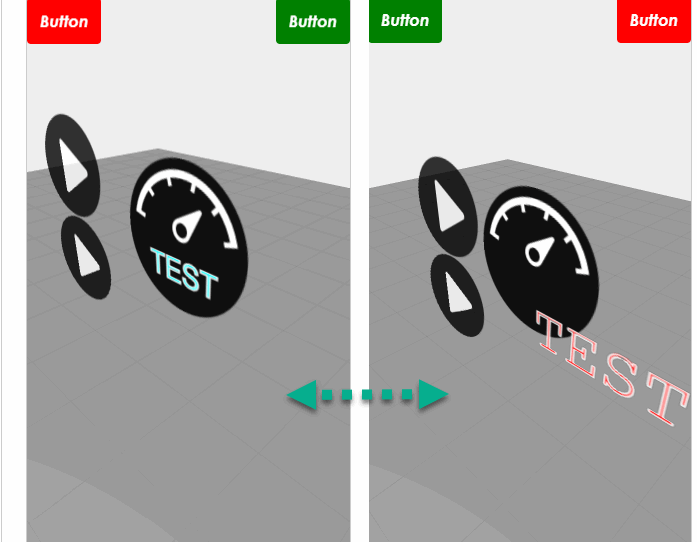

Any idea about changing the font outline too? It appears that the font outline of the text in 3D gauges is white by default. It doesn't give a smooth transition effect unless the font outline changes too.
to have  an  apperance of the text outline like in this picture:
some code like this:
 $scope.setWidgetProp("3DGauge-1","textattrs","fill:rgba(0, 0, 255, 1);textbaseline:top;textalign:left;font-size: 40px;stroke:green;colostroke-width: 3px;");
$scope.setWidgetProp("3DGauge-1","font","Arial");
$scope.setWidgetProp("3DGauge-1","fontsize","30px");
and to have  an  apperance of the text outline like in the second picture:
  $scope.setWidgetProp("3DGauge-1","textattrs","fill:rgba(255, 0, 0, 1);textbaseline:top;textalign:left;font-size: 40px;stroke:black;colostroke-width: 3px");
    $scope.setWidgetProp("3DGauge-1","font","Courier");
   $scope.setWidgetProp("3DGauge-1","fontsize","60px");

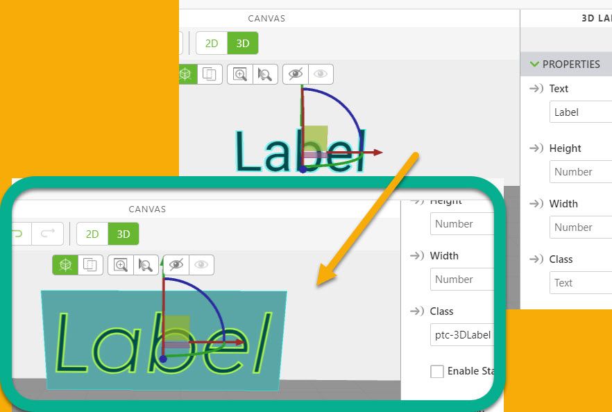

But how to proceed the same modification to a 3D Label Widget?
let theColor = 'rgba(' + R + ',' + G + ',' + B + ',1);';
$scope.setWidgetProp("3DLabel-1", "fontColor", theColor)
$scope.setWidgetProp("3DGauge-1","textattrs","fill:" + theColor + "textbaseline:middle;textalign:center;font-size: 40px;stroke:white;colostroke-width: 3px;");
The code above modify the Text Color of 3D Gauge Widget Text, but does nothing to 3D Label Widget Text.
What to resolve the issue?
Thanks in advance.
Hi @dsgnrClarK ,
yes , this is a good question. In fact I needed some tests to find out the difference here. I think this is a point what depends on the internal implementation of the widget.
So , what I believe (not 100% but seem to work) is that the Text appearance attribute on the toggle does not follow a CSS definition (also there is not explicit class attribute for this widget) but it use the SVG attributes according to the SVG attribute reference
https://developer.mozilla.org/en-US/docs/Web/SVG/Attribute
e.g.
https://developer.mozilla.org/en-US/docs/Web/SVG/Tutorial/Fills_and_Strokes
The 3D label widget seem not to use the SVG attributes but it could be driven by the properties (Font Family Font Color, Font Outline Color and scale ) dr Also for the 3d Label you can use css style definition according to the Vuforia Studio Help : http://support.ptc.com/help/vuforia/studio/en/#page/Studio_Help_Center%2FWidget3DLabel.html
So for example the class defintion in the STYLES >Applicaiton :
.ptc-3DLabel {
  	font-family: Century Gothic;
  	color: black;
  	--text-stroke-color: yellow;
  	--text-stroke-width: 3px; /*csslint ignore*/
  	font-weight: normal;
  	font-style: italic;
  	background-color: grey;
will change the apperance of the 3DLabel to :
