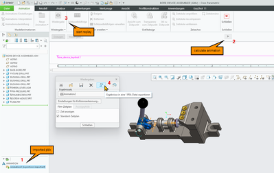

You see i want all these 5 Folderlike things, that include .pbk-Analysis I created in Mechanism in just one scale. But i can only open one in one scale right now and its impossible to create the desired flow in just one .pbk. So how can I put all 5 of them on this blank scale?
Hello User.
You created several animations in Creo Parametric. These are defined and stored in the assembly file (and as pbk). To answer your question, we need to know, what your goal is.
For example: to drive these animation into a Vuforia Studio experience, you need following steps:
Two additional hints:
in mechanism. you only need →
It is not necessary to use "design animation" only to animate the mechanisms (just export the FRA files and do the rest in Illustrate)
Design animation in Creo Parametric helps in cases, when you want to create animated exploded views and / or interpolate between snapshots
The screenshots were created in Creo Parametric 9 and Illustrate 12.1 with a german UI (on purpose. The english UI uses the same icons 😉 )
Hope that helps
