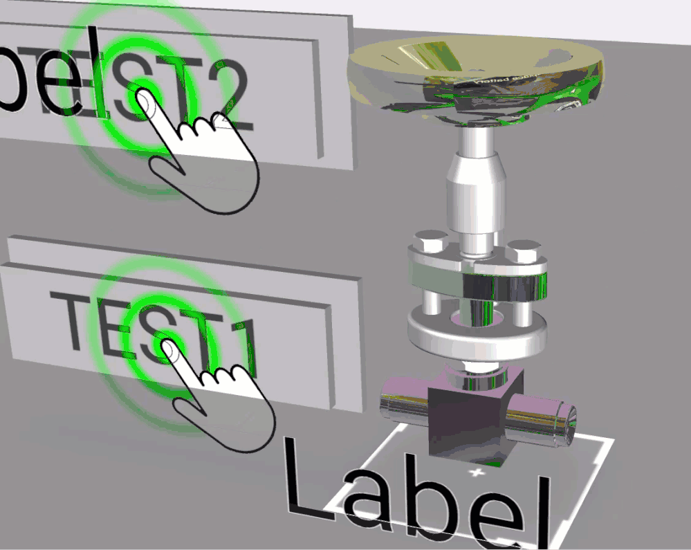

Here is an example /sample project  for ping shader for HoloLens. The project requires 2 definition of the same shader - one for GLSL and one for HLSL. So here we can check the current mode and if it is preview then use the pingergl shader and otherwise we can use the pingerhl shader. In the demo project the both shaders are defined in separate TMLText widgets. To check the mode called window.twx.app.isPreview()
new version of the Eyewear project attached here - it contains also implementation of the reflect shader for both  preview and HoloLens device:2021-10-29_07-41-59.gif

Hi @Wes_Tomer ,
the best impression of it - hwo it looks like will be if you load the demo project form the post https://community.ptc.com/sejnu66972/attachments/sejnu66972/studio/10291/1/propSetComponetsHoloLensExamleCommuntyShaderUsageReflect.zip  and test it in the Studio environment. You need simple import it as project in the env.
The main goal in the previous post is to provide an example and to demonstrate  how to create a shader which will work in preview mode (GLSL also it will work on android and on IOS) but should work also on eyewear device (HoloLens 2 as HLSL) The shader definitions sample are for reflect , xray and pinger shaders.
Regarding to pipe flow shader  could check this post : https://community.ptc.com/t5/Vuforia-Studio/Simulate-Fluid-Flow/m-p/670190#M8349
This post is working currently only for GLSL –(Preview, android and IOS) if you need it for HL2 device , then ,please, let me know so I will try to create a HLSL example of it. Thanks!
