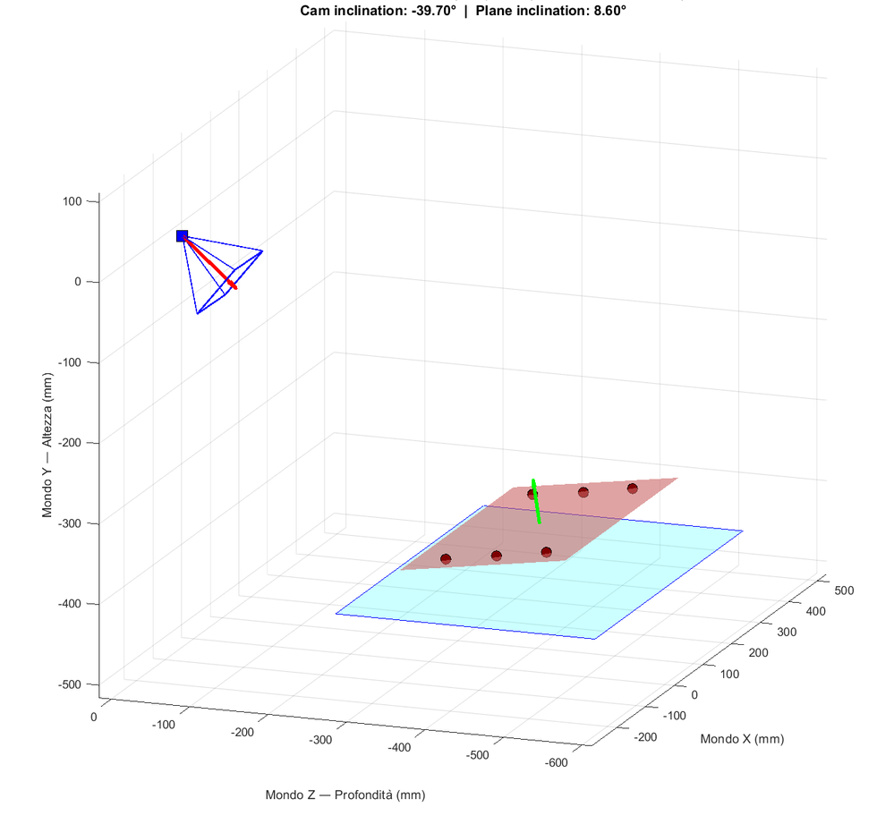

I have tested this setup using both a standard PC webcam and an external Canon DSLR camera with a 50mm lens. Using the 50mm lens significantly improved the overall tracking precision and almost completely eliminated the "bowl effect" spatial distortion caused by wide-angle lenses, but a systematic error persists. As I slide the target away from the center of the camera along the depth axis, the tracked height systematically drops or rises instead of remaining at zero. This creates a virtual tilted plane effect, although the tilt angle is noticeably smaller with the 50mm lens compared to the standard webcam.
Plane visualization made with MATLAB (webcam)
