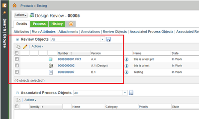

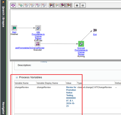

Very doable.
Here's a Promotion Request with three objects set for promotion.
I initiate my test workflow that has a variable to store the Change Review that will be automatically created by the workflow.  This variable is used just to make it easy to open the Change Review object after it is created by the workflow.  It's not required.
The workflow is advanced to run the code to create the Change Review and add the promotion objects to the Change Review. The workflow variable now displays a link the newly created Change Review
Opening the Change Review object by clicking on the link show the promotion objects on the Promotion Request are now also on the Change Review object as Review Objects.
Seems to be bombproof. 😊
