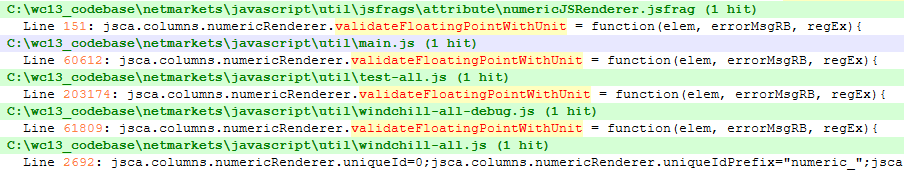

I started poking in to see how this could be done. I noticed that attributes with real numbers with units have a JS validation script associated onBlur. The function is "jsca.columns.numericRenderer.validateFloatingPointWithUnit" but surprisingly, this function is defined in 5 different locations in the codebase. Not sure which one is the one called when the attribute entry is validated but it should not be too hard to narrow that down.
Digging further, this function simply takes in a regular expression and ensures that the entry matches it:
Pumping this into AI let's us know what its checking:
The regular expression [^0-9\-\,\.E] matches any single character that is not a digit, a hyphen, a comma, a period, or the uppercase letter E.

My thought would be to hook in another JS call before all this to transform the input if it encounted a "/" character in that first part, converting it to a decimal. What do you think? I can call it only if it detects a "/" otherwise pass through. Still strange there is 5 copies of this function floating around...
Ok, I ended up taking this path. I modified the numericJSRenderer.jsfrag file instead of putting my stuff in a custom.jsfrag files. Why? Well, I had to make changes to jsca.columns.numericRenderer.validateFloatingPointWithUnit() to have it call my method first so figured it was one less file to manage. So, basically if we detect a single /, send it to my fuction to convert it back to decimal. If it ends up detecting bad input, it returns null, and normal error message. If not, modify the value and also update the input field to show decimals. Seems to work great up need to test a bit more. Here is code. If you spot a bug or edge case, let me know.
