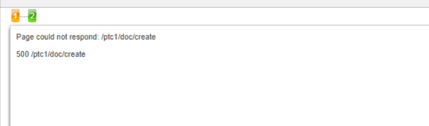

The following steps which we have followed to create custom WTDocument numbering using two wizard steps
1. custom action and action model
2 Main wizard
3. Wizard step one and two
4. Error message
com.ptc.core.components.jsp.JspUtils wcadmin - java.lang.NullPointerException java.lang.NullPointerException
at com.ptc.core.components.tags.components.InitializeItemTag.doTag(InitializeItemTag.java:371)
at org.apache.jsp.netmarkets.jsp.doc.Second_005fWizard_jsp._jspx_meth_jca_005finitializeItem_005f1(Second_005fWizard_jsp.java:1939)
at org.apache.jsp.netmarkets.jsp.doc.Second_005fWizard_jsp._jspx_meth_c_005fotherwise_005f1(Second_005fWizard_jsp.java:1903)
at org.apache.jsp.netmarkets.jsp.doc.Second_005fWizard_jsp._jspx_meth_c_005fchoose_005f1(Second_005fWizard_jsp.java:1808)
Earlier we have tried the same activity using single wizard page, it was working as expected.
Please let us know if anybody aware of it.
In the first action try to set the windowType to "wizard step"
Yes i tried the same, windowType to "wizard step". The issue is same
https://www.ptc.com/cn/support/article/CS242901 , I tested your code, this article will fix the error, but the interface won't show anything, if you want to add custom steps when creating a document, I think you should modify the /netmarkets/jsp/document/create.jspf,this is just my personal suggestion, because I didn't come across a button that needs to create a custom document
Hi @Daniel_Ada
Your issue is connected with a component that you would like to show but it does not work.
Try @RG_10893406 suggestion based on the article
here is an example how to define it
<jca:initializeItem baseTypeName="wt.doc.WTDocument" operation="${createBean.create}" attributePopulatorClass="com.ptc.core.components.forms.DefaultAttributePopulator"/>
btw you can not define two same jsp steps.
first step should define different jspf then the seccond one create.jspf
so I guess there could be the issue, where one jsp tries to overwrite something in the second one.
Share the create.jspf and try to use own jspf page.
