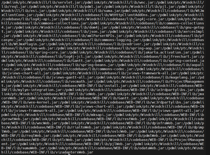

I added in the line to setup Windchill shell environment, but am still getting class not found exceptions when compiling. I tried adding my jar files to the classpath when compiling, which is when I noticed that each file was separated by a string, when they should have been separated by a colon.
After putting all the the jar file paths into a string variable (separating them by a colon) I'm still getting Windchill class not found errors.
Here's what my jar_files_str variable looks like: (full paths of jar files separated by ':')
