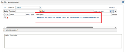

@Vishwa_RADDI ,
I saw your post and it seemed very doable.
I renumbered a WTPart to be 6 characters long.
As expected, I get a failure and the error description is exactly what I coded.
Seems to work to your spec, unless I'm misunderstand your post.
David
