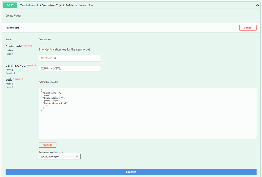

Hi @nbojcetic
Try to create the folder from a Windchill restApi documentation UI.
You can try it from the UI and you can find if the json is well formatted.
https://serverAdress.com/Windchill/netmarkets/html/wrs/doc.html
examples
"Folder@odata.bind": "Folders('OR:wt.folder.SubFolder:199456')"
"@odata.type": "#PTC.NavCriteria.WTPartStandardConfigSpec",
for the type I would try to find a type for the SubFolder. I guess it could be something like
"#PTC.Folder.SubFolder" but I don't know exactly.

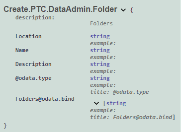

@nbojcetic , @VB_2025784 Please use the Swagger UI to run endpoints, your payload does not contain all necessary data as @HelesicPetr explained.
Also, it could be a permission issue, try to create the folder on the exact context with the same user on the UI; but I guess it's not the root cause.
Any idea how to add the service to a ThingWorX OdataConnector? I found the endpoint createContainerInContainers/v6/DataAdmin/Containers Post but create Folder isn't shown. Looking at the Swagger JSON the parameters should be what is shown below. I tried adding that to the JSON Container parameters but it is not considered valid. I am looking for a way to create folders in Windchill from ThingWorx.
"parameters" : [ {
"name" : "ContainerId",
"in" : "path",
"description" : "The identification key for the item to get",
"required" : true,
"type" : "string"
"name" : "CSRF_NONCE",
"in" : "header",
"required" : true,
"type" : "string"
"in" : "body",
"name" : "body",
"required" : true,
"schema" : {
"$ref" : "#/definitions/Create.PTC.DataAdmin.Folder"
