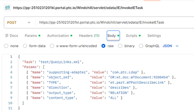

You can make and info*engine task that creates objects and call it in WRS using invoke task endpoint
something like below ;

Turko
(To:Fadel)
Thanks very much @Fadel !
