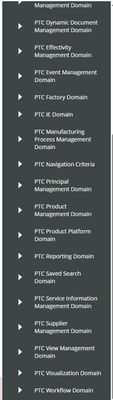

I am trying to find the Project Management in the WRS, but I am not able to see:
 Apart from that, I need to get the details of the Projects and their plans. Does anyone know what those APIs in WRS are for getting the project details?

After researching many PTC articles, I realized there is no WRS for the Project Link. If needed, customization needs to be done.
Reference Link: https://www.ptc.com/en/support/article/CS399829?source=search
