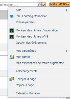

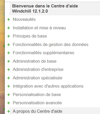

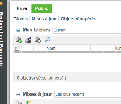

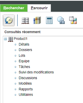

This example has only one language installed in addition to English – French.
Install
Every Windchill file that are used to display English words now has an additional similar file with the language (fr for French in this example).
Because these exist, each user can select their desired language (of those installed) at any time.
Default English:
Each user has this choice (list will include those language(s) which have been installed). Does not affect any other user. By moving English back to the top, it will revert to English at any time.
After browser refresh:
